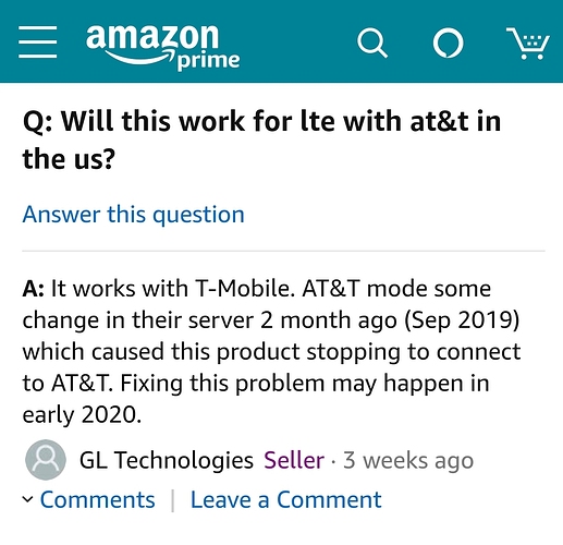

Does the GL.iNet Spitz (GL-X750)LTE router you linked above still function using the AT&T plan? I see these manufacturer posted a reply on a question with a Amazon about using with AT&T that it currently doesn’t work with AT&T plans as of 3 weeks ago and might be fixed in 2020.

Yes, it works perfectly fine with AT&T. Getting good speeds in my area with low signal.
