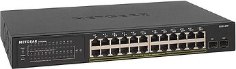

Cheapest PoE & SFP: Netgear GS724TP
  • Price: Amazon $231 / eBay $220
  • Ports: 24x1G , 2xSFP+ 10G
  • PoE: 190W, 24 PoE+ Ports

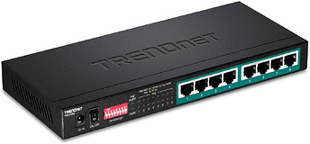

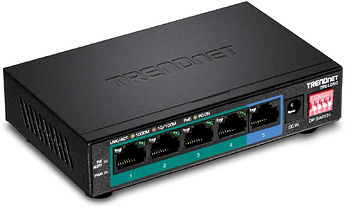

Cheap PoE 1G Switch: TP-Link 5/8 Port PoE
So even if you hobbled together some of the other switches you’d still come up short compared to the value you can get out of these Aruba units!

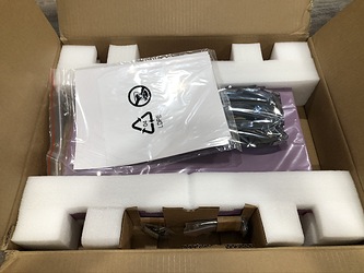

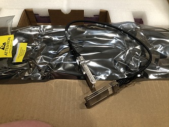

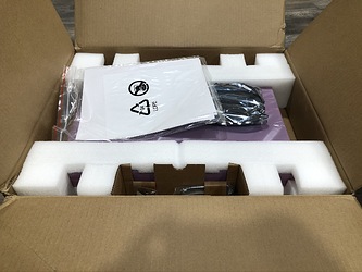

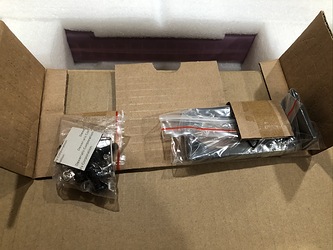

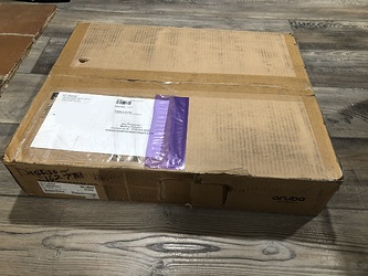

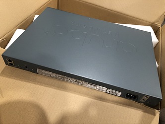

Unboxing
Here are a few pictures I snapped during my unboxing

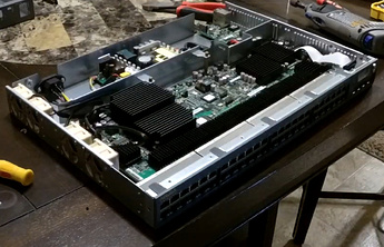

Silencing Mod
The noise during normal use is completely unremarkable, but if it does bother you there is a guide for installing 40mm Noctua fans to make it completely silent.

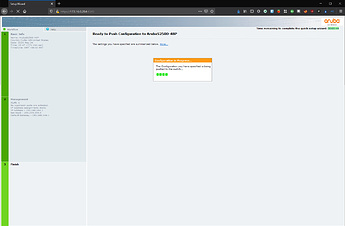

  10. You’ll be presented with a summary of the changed you made, feel free to review them and then click Finish.
  11. The switch will start saving the configuration
  12. Once complete you should see a confirmation:
  13. Now you can plug your switch into the network with the rest of your devices as well as the PC you’re using to configure it. You might need to ipconfig /release & ipconfig /renew on your PC to get a normal DHCP lease again. Once you’ve got a normal DHCP lease, or have configured a static IP for your PC on the same subnet that you set the switch to you can access the web interface via http:// (for me http://192.168.144.2) and it will redirect you to the https login page.

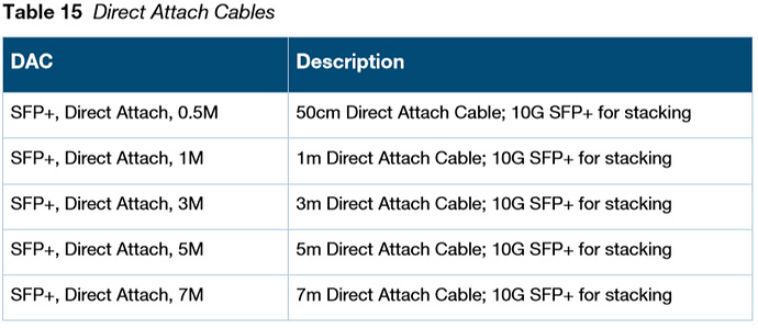

Officially Recommended SFP Connectors
Oficially Recommended DAC Cables
Official support list from Aruba Thanks @seanho!

Bought one of the 48 ports, I’ll get back to you all about the DAC Cables. I have a spare so I’ll use it and report back when I get it hooked up.
i have a 24POE
The cable mine came with which i literally cannot find right now, was some no brand 1.5 foot sfp+ cable that ill post a model number for if and when i find it works with Mellanox Connectx-2 Cards i found on ebay model# HP 671798-001
However, those cards DO NOT work with this 10Gtek cable (but not sure if it wouldn’t work with other cards, I do not have others to test yet but looking at some cheap solar flares i put a bid on)
I also have a gigabyte GA-7PESH2 Board from the NSFW Anniversary 1 Build that is working great with this generic transceiver and a random Cat6 Cable
updated - 74752-1301 Molex 10GB SFP+ just received these cables and they work with the CX-2 Cards i have.
