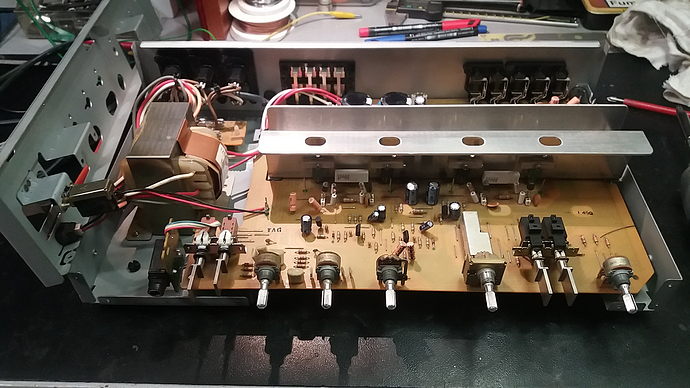

An overview of an Integrated Amplifier
Pictured above is a Pioneer SA-410 integrated amplifier from 1980. It’s wide, but short, and not very deep. It has multiple inputs for an external Tuner or CD player, Auxiliary, and Phono (for turntables). It also has tone controls for bass and treble, as well as A/B speaker outputs and a headphone jack. It provides a modest 20 watts per channel, but is plenty loud for most people. It will absolutely destroy a similarly priced modern headphone amp or speaker amp. Typically you can find one of these for under $200.
It’s amazing that one of the best sounding integrated amps looks like a high school intro to EE project.

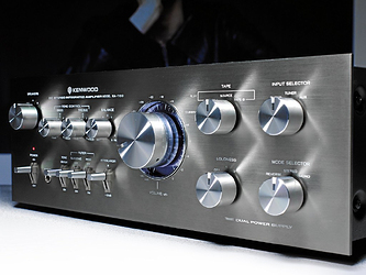

  • Kenwood
    Definitely not what they used to be. Late 70’s Kenwood stuff is simple, beautiful, and highly functional.
    Nowadays, vintage Kenwood is extremely affordable, solid performing, and not as sought after as some of the other brands.
    Kenwood’s house sound is neutral/reference leaning, with a little “smooth jazz” thrown in.

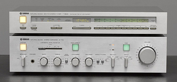

  • Yamaha
    Yamaha had a stranglehold on the early to mid 80’s market. They are known for their insane specs, clean and fast amplifiers. Their vintage aesthetic is still used today in their modern products.
    Yamaha’s house sound is similar to Kenwood’s, but even more analytical and reference.

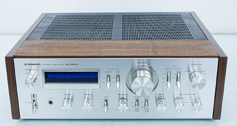

  • Pioneer
    Just like Kenwood, not at all what they used to be. Pioneer has some of the most sought after vintage equipment, and not just their amplifiers.
    Pioneer’s house sound is dynamic, punchy, and very “rock n’ roll”. For the most part, it’s not reference at all - but that’s why people love Pioneer. Generally, more expensive than a similar Kenwood unit, but Pioneers are rarely a bad purchase.

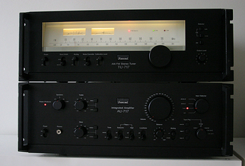

  • Sansui
    Extremely expensive nowadays. Most Sansui stuff you will find will be black, not silver. They are great, if you can find one in your budget.

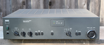

  • NAD
    Sometimes good, sometimes just OK. Known for their extremely simple design and general reliability. Make sure to do your research on the model you’re looking at!

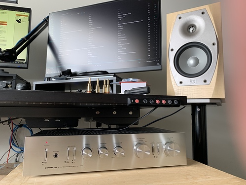

Pioneer SA-410 with Infinity IL-10 bookshelf speakers at my main desk.
I’ve used Sennheiser 6XX, 58X, and Focal Elex headphones - all sound the best they ever have on this amp.
Source is a Motu M4 audio interface.

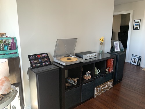

Moved the SA-410 to the kitchen hallway to test a new Sony Turntable.
The iPad Pro is used as a digital source.

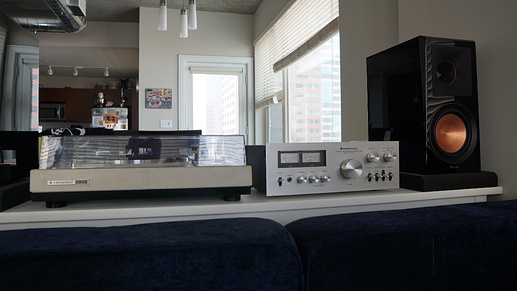

Kenwood Turntable + Kenwood KA-5700 Integrated Amplifier as the primary listening station in the living room.
Speakers are modern, Klipsch RP-600M in Piano Black finish.
